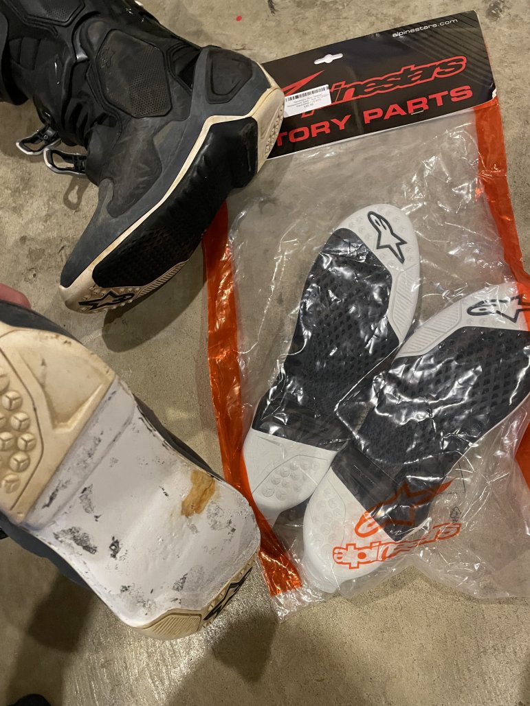

Anybody know of a local cobbler in NE Ohio that can resole boots? Decided to order inserts for my old tech 10’s from eBay but they ended up sending the whole bottom soles. I’ve checked with a couple cobblers near Canton that said they can’t do it. Doesn’t seem like you can order the inserts anymore either.

It’s really not that hard. Heat the old sole up with a heat gun, pry it off. Take a dremel to remove as much old glue as possible, clean with acetone and let fully dry. Next take some barge infinity cement, put it on the new sole and some on the bottom of the boot, heat new glue up and stick together. Hold for 3-5 minutes, and put 2 small vices on boot for 4 hours to let cure. Remove vices, let cure for 24 hours land you’re good to go. It’s the same method i use when doing sole swaps on old classic air Jordan’s and Nike SB dunks.
