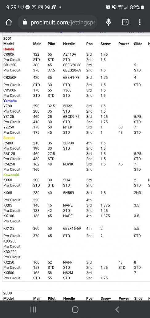

2001 RM250…..I’ve basically taken it back to stock. Only thing I struggled to know OEM is main jet. One manual I have says 162 and another says 172. I have the 172 in now. And I have the air screw out 1.5 out.
My first shot on any stock bike is drop the pilot one step and raise the clip one position and see how it runs. Most times I end up dropping the main one size also. The factories seem to jet them fat, also the test articles from the big magazines are generally California settings that are closer to sea level than we are requiring more fuel.
There is also this from PC. You have to take into account the fuel they use and the mixing ratio
Click on the link below to see their fuel specs

I believe 162 main 48 pilot is correct for stock 2001 RM250.
Depending on what it is doing, you probably need to move the clip position. Typically in hot/humid Ohio summer you need to lean the bike out, which means dropping the needle (moving the clip UP).
At Mid Ohio this past weekend, I needed to have my needle clip all the way up (dropping needle all the way down) in order for the bike to run right. Monday I immediately ordered a leaner needle for the bike.

But before you do anything, I would check clip position on the needle and possibly move it up a spot to drop the needle and then try the bike out.
