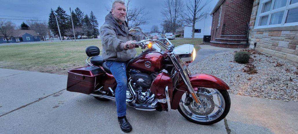

How about bringing the ole 125 and 250 out of moth balls. Fresh gas and it’s ready!
I just picked up a bike with around 6 hours on it since it was new, it hasn't been run in a few years, tank was full of gas it doesn't have a battery because no electric start, but it is FI. The fuel pump was seized from sitting, and the injector was plugged solid, after replacing both and the plug and oil, cleaning the tank and flushing all the line and new fuel I found 8 psi with a new pump, turns out the pressure regulator had also gone bad and was bypassing the fuel back into the tank. All from sitting. Definitely don't let it sit too long without starting and running fuel through the system.
That ride was for sure his loss your gain
Look out hells angels…
